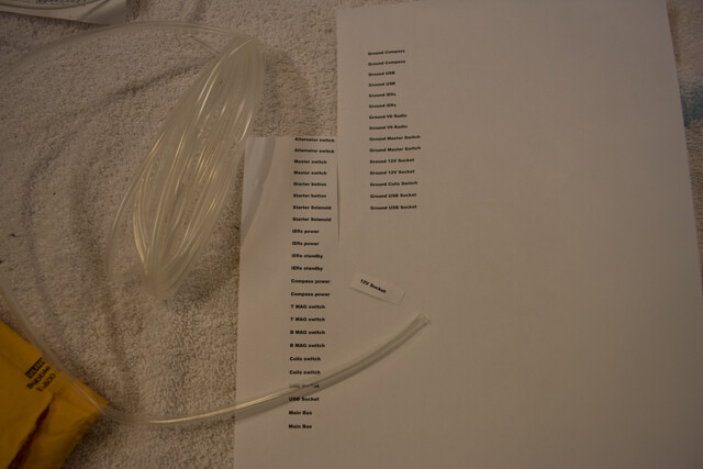

When wiring your electrical system it is important to label your wires at both ends for future reference. Here is a method I used to provide legible and durable labels for your wires.
Print a sheet of paper with the appropriate labeling for your wires. Use a small but legible font size. Remember to print TWO of each label since you will be putting the labels on either end of each wire.
 ![Image](https://sonexpilots.org/uploads/default/original/1X/5432697d45537fcaf37f625e5a9eb8d3e080a910.jpeg)

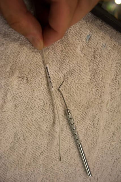

Get some clear heat-shrink tubing and cut it to length a bit longer than each label. BEFORE you crimp/solder the connector to the end of the wire, slide the heat-shrink tube onto the wire, then cutout your paper label with scissors and slide it under the heat-shrink. I found a pick-tool useful to push the label under the heat-shrink.
 ![Image](https://sonexpilots.org/uploads/default/original/1X/4900473a85e47e66f8e5d68b40bb3fd0432d65de.jpeg)

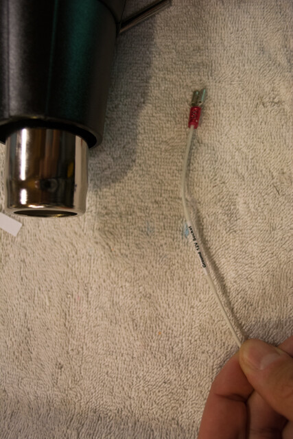

Use your heat source/gun to shrink the tubing, then crimp/solder your connector.
 ![Image](https://sonexpilots.org/uploads/default/original/1X/22a7368bb362f11a75f7b3aa221629d01092db18.jpeg)
Now you have permanent/durable/legible labeling on your wires!
