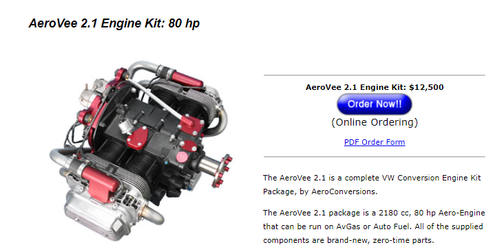

AeroVee Kit:

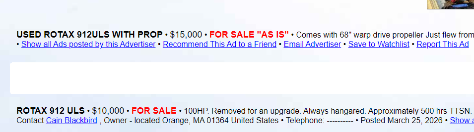

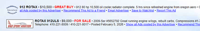

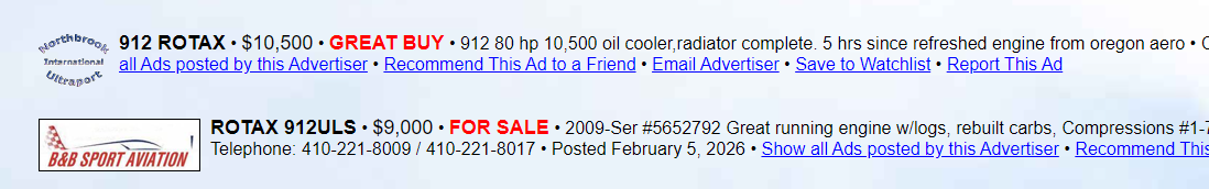

Complete, running Rotax 912s on Barnstormers right now:

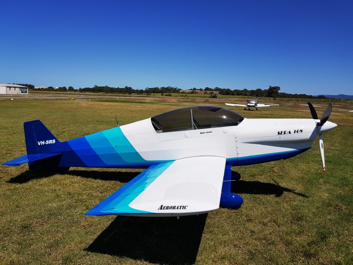

I would use the Sonerai innovations, developed by Robin Austin. RV performance with Rotax econamy.
He offered his ideas to Sonex & was rejected - This is how you make an aircraft company irrelevant/unviable. :smiling_face_with_horns:

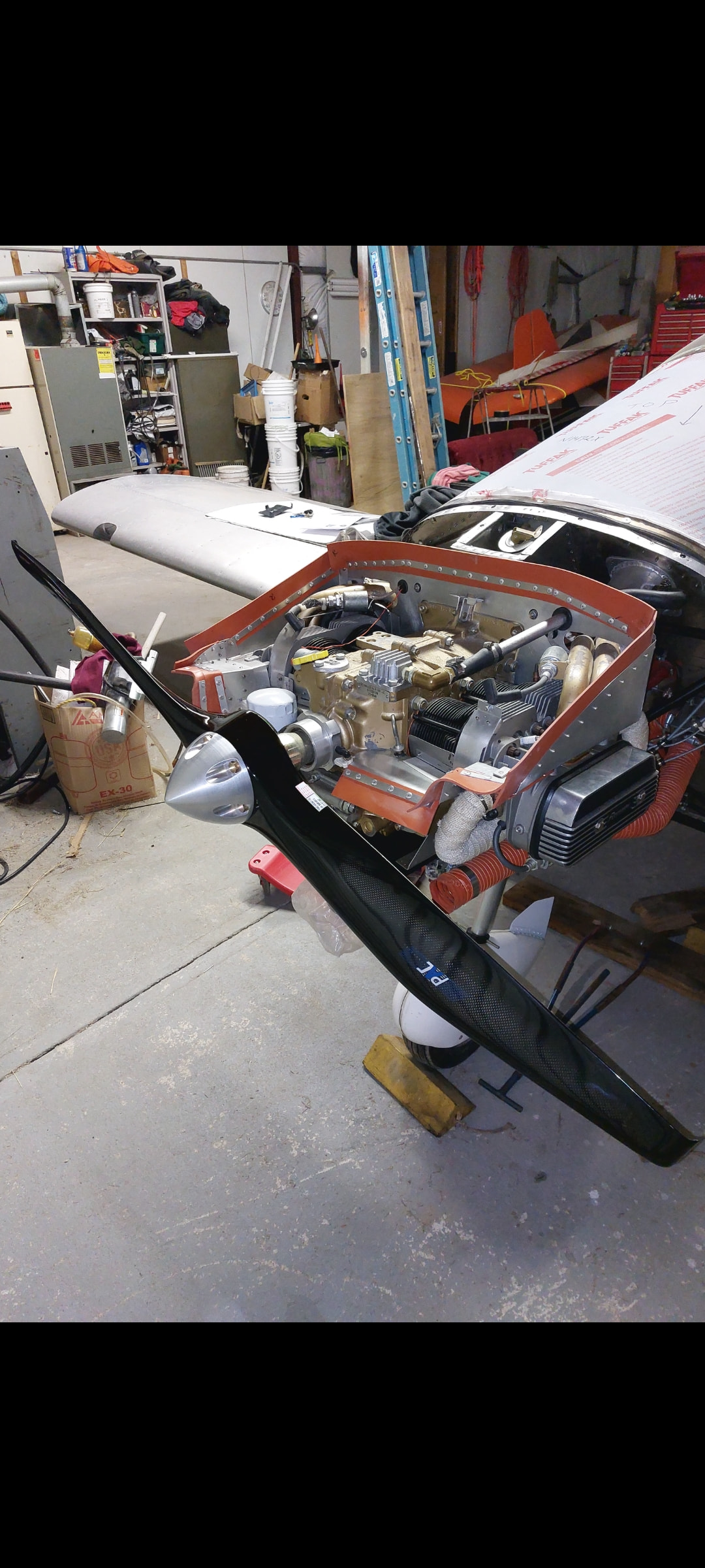

Another option not discussed is the Revmaster 2300… built for you and last i knew it was selling for 13K… mine was $8500, many years ago.
Yes! My Revmaster served me well on my Q2 for many years before I got the Sonex!
