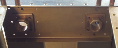

Months go by cutting aluminum smoothing edges, drilling holes, drilling holes again, deburring, dimpling, countersinking, reaming, cleaning and alodining, rerigging again, and here it is, time to start riveting. Here are some pictures of the start of the riveting. Next weekend will be the crossties and sideskins, then the turtledeck and formers.

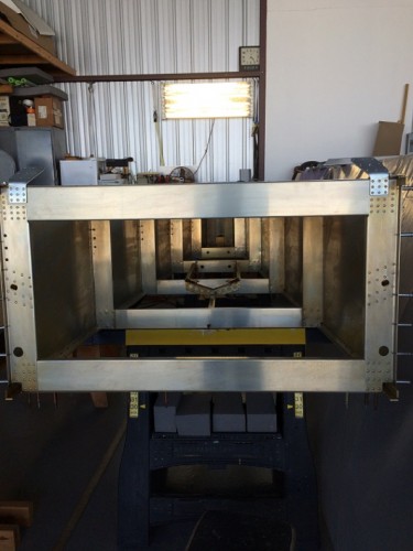

Front of crosstie box revited
I think I have avoided riveting myself into a corner so far. I have the interior of the aft fuselage riveted up. Here are some pictures. I got the turtledeck reinstalled now and that took about four times as many shims as I had made to close the gaps at the formers. This coming weekend will be riveting the turtledeck and then the back side skin. I plan to leave one back side skin off so I can rivet the rudder hinge on with 2117 rivets and my squeezer. Later on I will bolt on the Y after the tail feathers are final drilled, deburred, etc. Then the side will be final riveted on with access from the bottom as the bottom skins will stay off for a long while.
Re: fuselage progress now visible
Posted: Wed Mar 28, 2018 6:57 am
Looks great! Fun to make a big pile of parts look like something, isn’t it?
