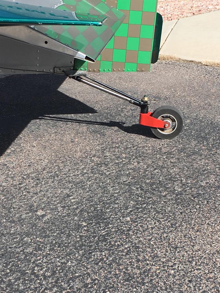

caveman371 wrote:
Myself and John Gillis have the flyboy accessories tail wheel. Direct drive from 45 to 45 then pops out with a tap of toe brake ( optional). I love mine!

That’s interesting I did not know it was available. I have had some serious skidding in my sonex with the small wheel . I attribute it to low weight of the tail along with some cross wind I did not get far enough ahead on. Have no idea if it would have broken loose during those times but I was thankful I had a solid tw and not a chain and spring coupled tw. How well would it break loose without individual brakes. I have a single brake lever so am curious

Your not gaining anything without having the optional toe brakes. I wouldn’t do that in your configuration

In the “flyboy” website there are 3 tw forks: “doug bell”, “screaming eagle” and “eaglet racer” .
Which one did you use on your Sonex?
Carlos
Full swivel tail wheel
Posted: Sun Apr 19, 2020 6:32 pm
by caveman371
I couldn’t tell you which one. I talked to them at Oshkosh a couple of years ago. I told him I had a sonex and he got the correct one for me. I did get the one for a RV ( a little bit different angle) He stopped making the one designed for a sonex because of some complaints by a few. He said if I didn’t like the RV type, he would build up a sonex one for me. Mine gives me a flatter landing angle but I have no problem with that especially if you like to wheel land a bunch.

The full swivel tailwheel made for an RV has the wrong angle for a Sonex/Onex.
I found that out when I installed the RV fork from Flyboy’s 2 years ago. After considerable back and forth emailing with Flyboys I sent them the proper angle measurements needed. They then “jigged up” to make the correct angle fork for future Sonex customers.
One of the big advantages with the full swivel is to be able to push the airplane into the hanger tail first as well as pivoting around on one wheel on the ramp…with toe brakes.
I have decided to go a different route and so have this brand new Flyboy’s full swivel tail wheel fork for sale.
It will accept a 4" or a 6" tire/wheel. This fork has the correct angle for a Sonex/Onex and fits the Sonex/Onex tail spring. I will sell it at a discounted price.

keep in mind, if you have the stock Sonex drum or even their upgraded hydro brakes… unless you have made some way to have differential braking… a full swivel tailwheel is not something you will want for your sonex. You need to have control over each brake separately to be able to lock or unlock the tailwheel.
There is a possibility that if the locking action is strong enough, you might be able to use one on a sonex with stock brakes, but you would only be able to use the advantages of it swiveling around by manually unlocking it, and really the only advantage at that point would be to be able to push the plane backways on the ramp or into or around the hangar.
I personally think the stock brake set up is cheesy and wish I had toe brakes. You can have so much more control over take-off and landing and taxi operations when you can individually control the brakes. I am sure what the plane comes with is probably the lightest, cheapest and most simple way of providing braking to the airplane and that is why it comes with what it comes with.

I wouldnt go back to either the the direct steering or solid rubber tire. Yes it is dirt simple and it works, those tires never wear out, but they are noisy and have a huge turning circle.
I made my own swiveling tailwheel with pneumatic tire and have been flying with it for the last couple of years. It uses the same scooter tires that Peter Anson uses. Peter, you will be pleased to know after seeing Cavemans photo of the fylyboy tailwheel. I had enough inspiration to make a new lower fork. This raised the wheel and lowered the tail by 40mm. Just did the first flight this morning with 3 landings, No shimmy which was good, just a bit heavier on the steering and less visibility taxiing.
