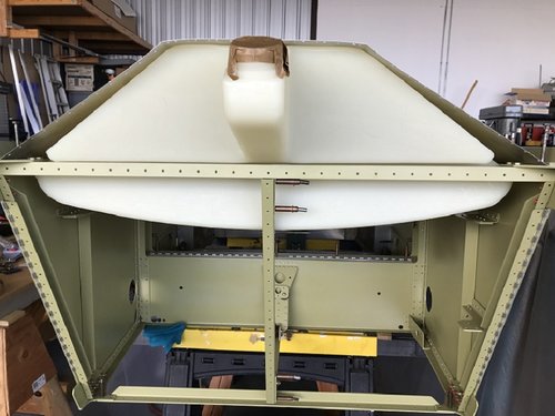

I installed the front strap and by tightening it very tight I was able to get about 1/32" gap between the tank and firewall stiffener.

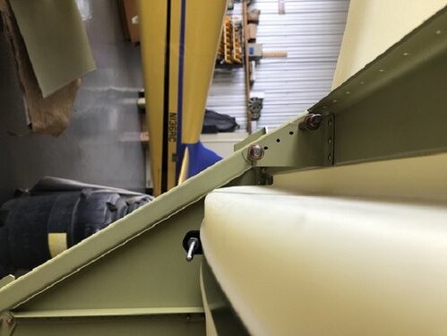

But, since the tank is not symmetrical, the right side of the tank pushes up the glareshield and there is a gap on the left side of the crosstie.

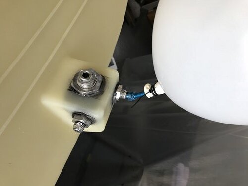

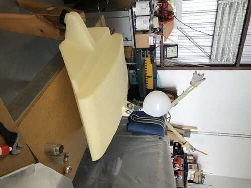

I installed the oops fittings but did a crappy job of it. I tried to get the mound of plastic off the inside using a dremel wheel & stone. On one I made a small groove where the o-ring would sit. But worse, the fitting on the side as right in the corner of the tank and the fitting would not fit. Working at it with a dremel stone I worked the plastic back inside the corner but in the process the 9/16" hole became 5/8". The o-ring was right on the edge of the hole. My fix was to make two aluminum sheets that fit inside the tank and use Fuel tank sealant from Van’s Aircraft to seal between the plastic and aluminum sheets and also seal the holes around the oops fittings. This worked.
Oops fittings sealed
Pressure tested and it held pressure over the weekend. I call it done. Enough with this fuel tank.
