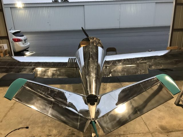

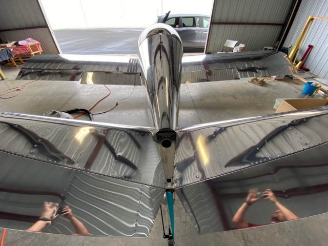

Hi,
I spent many hours using nuvite to polish my sonex. For me, it was a dirty job personally and to my shop. It’s highly likely I was using poor technique or something even after watching Kerry’s excellent instructional nuvite video. I called it good enough and moved on. I then backtracked to a recommendation to try Zephyr PRO40. It is a product that is popular with semi-truck drivers. My first application to the sonex was all by hand. Goes on and off like car wax. This resulted in a better finish than what I could do with nuvite. I passed the recommendation on to my sonex friend Russ. He purchased a 6" orbital buffer from Home depot and sent me some pictures that inspired me to I purchase a 10" rhobi orbital buffer to apply the zephyr product. Wow, what a difference and easy!!
A few amazon ads indicate conterfeit or watered down product. Russ tested this out and found that the factory direct versus amazon did have a different consistancy but the effectiveness was the same.
I don’t believe pictures will capture the end result well but for me, the key is eliminating the backbreaking work and the mess- all probably due to my inabilities with nuvite. AND the end of fighting with polish build-up around each and every rivet- this doesn’t happen with Zephyr.
I have no stock in zephyr, amazon, or any gains that may be implied by this post. I just wanted to share my great luck with the product. I do wish I would have purchased a cordless orbital buffer to avoid wrangling the electrical cord.

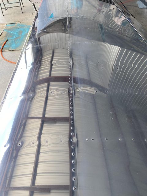

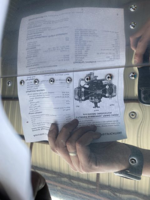

Posted: Wed May 13, 2020 8:04 am
by Matt541
Got my bottle in yesterday, I’ll say my first impressions are good.
I only went after a few areas with a new microfiber towel, but it does appear to work as advertised. The product is definitely thinner than nuvite or other polishing compounds. It WILL NOT remove scratches and water spots. It is not for an initial polish IMHO. (The bottoms of my wings were never polished, applied some, need something more abrasive for sure.) But for maintaining or refreshing a polish, I think it works well.
Pro 40 used on the left, untouched on the right. (Turtledeck being prepped for paint.)
3’-5’ away it looks wonderful, closer than that and you can see any scratches or water spots.
I think it will work even better using a buffer/ polisher, but that task is a few items down the list.
