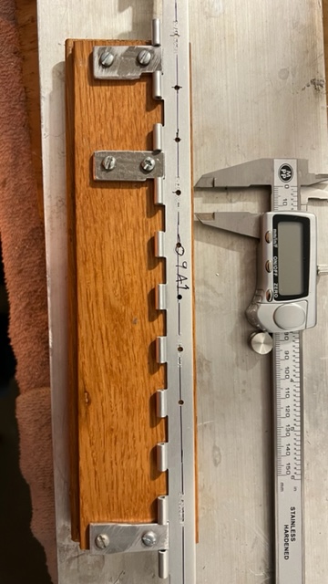

Made a hinge drill / index tool with aluminum tabs and oak. All holes are drilled identically.
