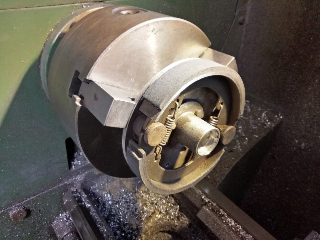

I have the original Azusa drum brakes, complete with the pressed steel drums. They were never great although when they were new reached the dizzying height of adequate, but lately they have become very ineffective. An engine run-up at 1900 rpm was about their limit, and after the run-up the right hand brake was tending to stick on. I assumed well worn linings but what I found was that they were badly glazed and one of the liners had half separated from the shoe. New shoes from Azusa plus freight and an unfavourable exchange rate meant that a new set would cost well over A$100 so I decided to see what was available locally. A local automotive brakes specialist was able to get the shoes relined for A$70. This sort of repair used to be common but there is apparently now only one business in Melbourne (I guess that makes it in the whole of the state) that can still rebind brake linings. I machined the new linings to match the drums and also took some care centering the drums on the wheels.
I took very fine cuts because it’s only springs holding the shoes in place.
The end result was a dramatic improvement in the braking. I feel that they are much more effective than the original shoes when new, possibly due to having really good fitting shoes but could also be different lining material. I guess time will tell if the improvement is permanent.
