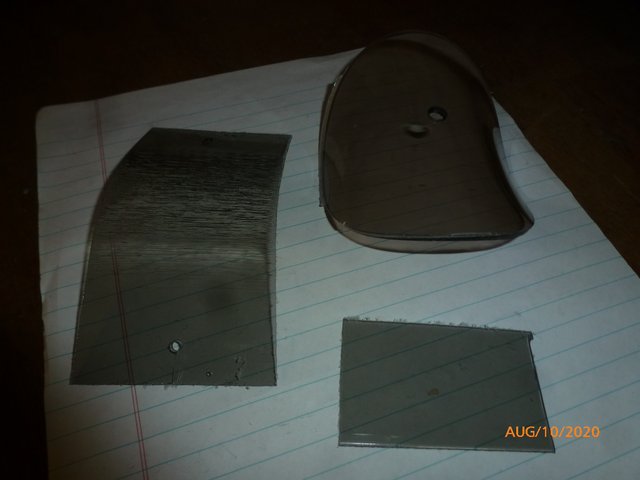

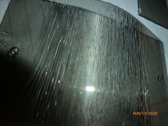

Not canopies, but a related topic. Wind screens. I performed a series of experiments related to Lexan and fuel exposure. Fuel will cause Lexan to craze only if the Lexan is under stress. You can soak un-stressed Lexan in car gas, and it won’t craze.

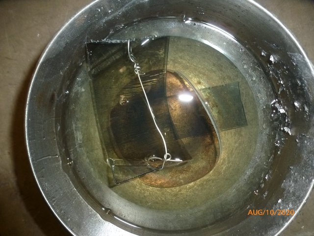

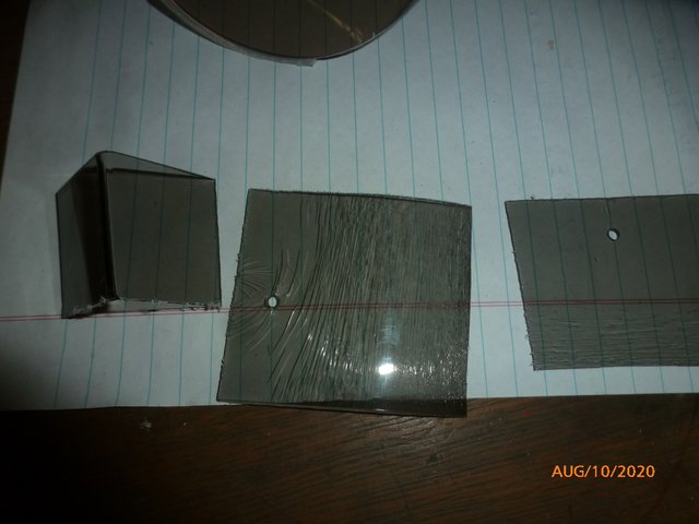

I would say it plays the major factor. I took my cutout scrap from making the fuel fill hole in the Onex windscreen and “Drap Formed” it over a coke can in the kitchen oven. I soaked it in car gas and 100LL with no effect. I stressed a piece of polycarbonate from Home Depot and soaked it in car gas. It crazed almost immediately. I soaked a small piece of Home Depo “stuff”, unstressed, and no effect.
After soaking, I pinched the stressed piece between my fingers and it snapped, as expected. I pinched the unstressed piece between my fingers, and it just folded like an unexposed piece would do.
