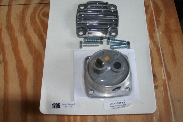

I still have my Maxi Pump in the packaging that came with my AeroVee (which was originally intended for a ONEX with a top mounted oil cooler)…it shows that its from CB Performance with part #1795. I’m not sure if there are any differences between 1795 and 1796 so you may want to give them a call to figure out which one is best for your application.
Top Mounted Oil Cooler Maxi Pump

Thanks for the picture Frank! The information on the website says that there’s a few different pumps of the same design depending on which case you have. I’m sure the part that Sonex sent you #1795 is the one Sonex sends out and is correct for the AeroVee. I’m glad you had the picture!

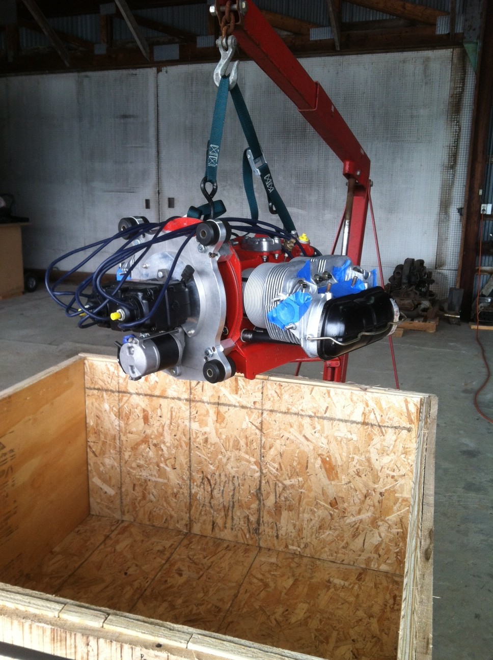

Those were not installed at that point, those pictures were taken when the engine was still at the previous owner, he was working on the valve train geometry etc at the time.
I have a set of new Scatt pushrods & solid rocker shaft upgrade that will still need to go in before finalizing all that.
You can see the tubes in this picture temporarily installed when the engine was about to be shipped to me:
crate 2.JPG (353.53 KiB) Viewed 9170 times
